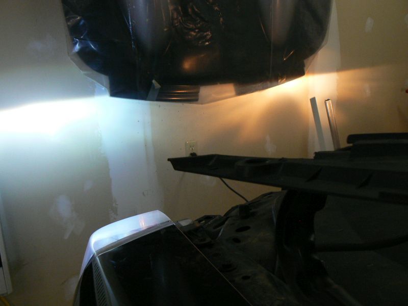

Picture of the headlights shining on the garage wall. The left is the new HID. The right is a 1.5 year old Sylvania ExtraVision.
The HID is much whiter than the old bulb.

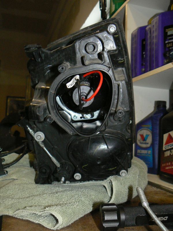

There is room for the ballast and other hardware in the side compartment of the headlight housing.

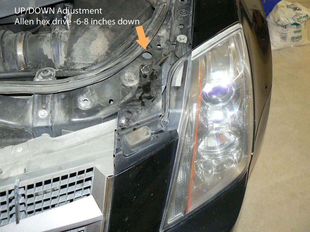

I did have to adjust the headlight slightly down. Before you put the top cover back on... The adjustment screw requires a LONG allen hex drive down this hole.
