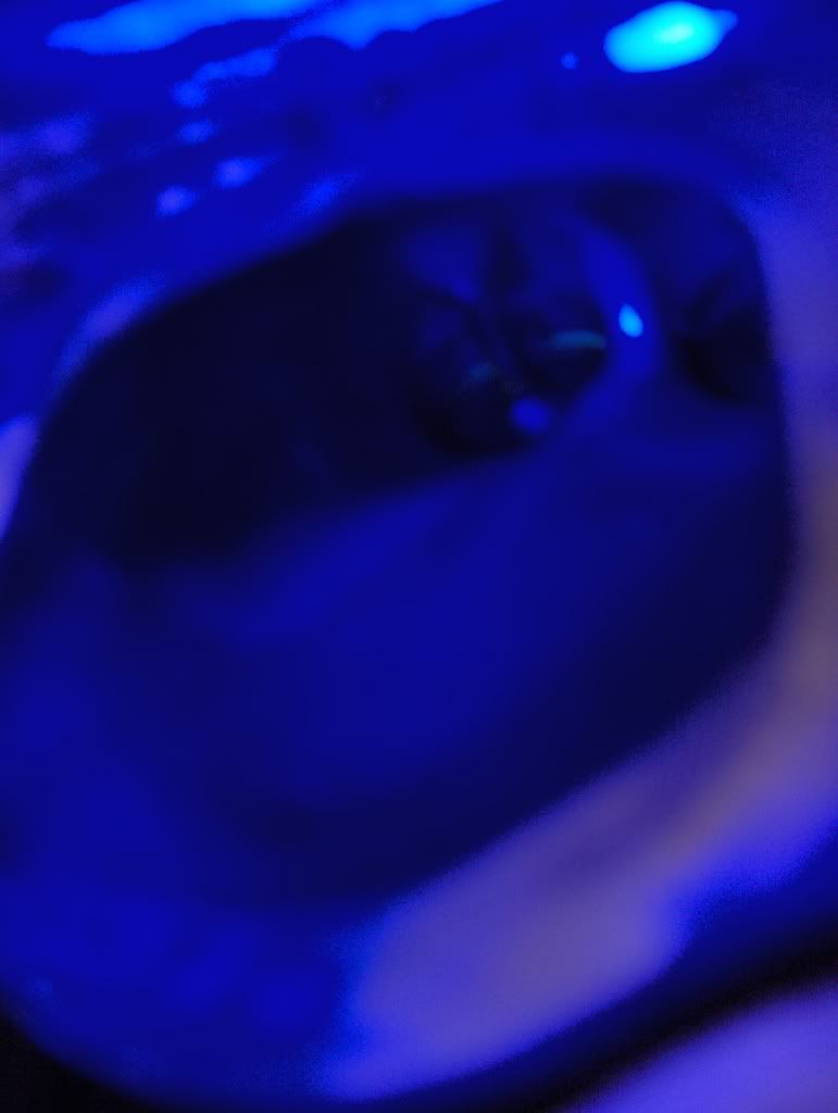

This is the intake valve. Black light. I ran the car 1/2 hour and test drove it 5 miles before I pulled the intake.

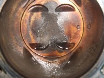

This is a 3.6L that drank oil
First oil change was about 10K
The ring are not the problem.
Oil leaking from the valves

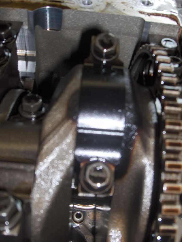

If you let it get too low you will see this.
