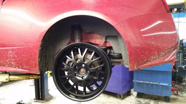

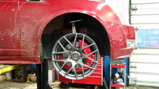

excuse the dirt its been snowing every other day here in ny...have the black rim being powder coated gun metal gray to match the front. the back rim actually hit the caliper bracket slightly need to add a 3/4 inch spacer.. the tremblant fronts i dont really like with the 1 inch lip they look hideous in my opinion.

3/4" is a huge spacer, hope you're going bolt-on for that. I would definitely measure for fender clearance as well. What's the effective offset between the wheel and spacer?

With wheel + spacer? Just checked TSW website and they don't even list a 19x9.5 fitment for the CTS, which explains why you're running into clearance issues. Judging by their other 9.5 width wheels, it's a 45mm offset, plus the 19mm from the spacer. You plan on rolling the fenders?

correct on the offset..id roll the fenders if need be but when i had them mocked on the car without tires i had no clearance issues on the fenders that i could see but the car was also in the air..cross my fingers hope for the best!!
