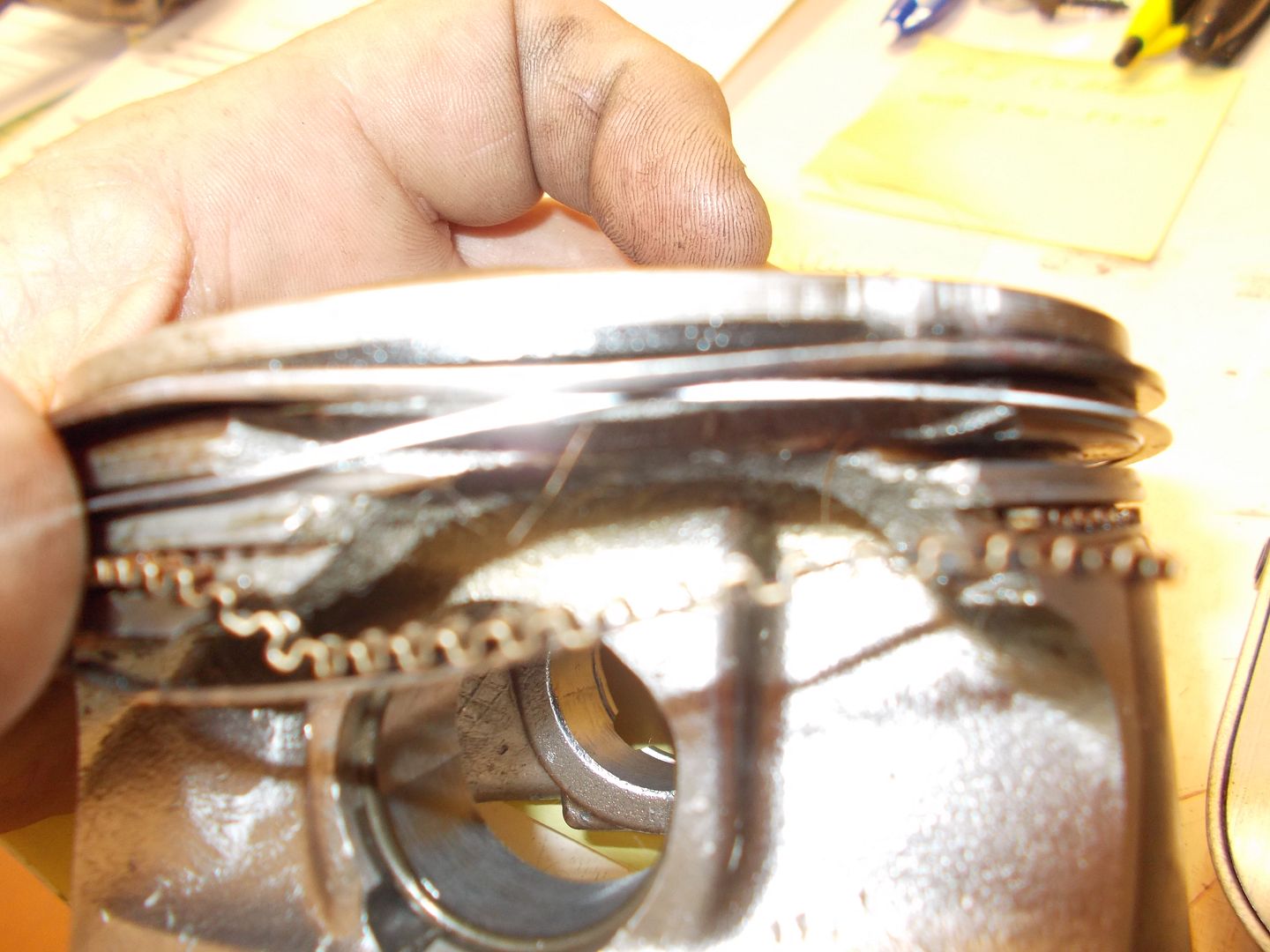

Here is a piston that was caught shortly after breaking before more damage was done:

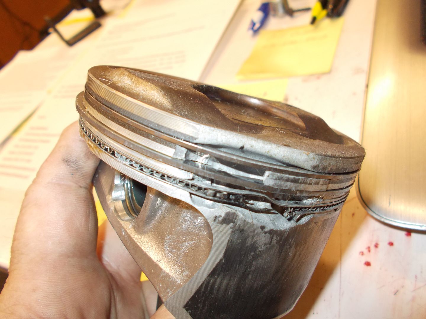

Here is another that was run for an extended time AFTER the ringland broke and the ring seal was breached. As you can see the flame melted (blow torched) causing more damage as well. This piston shows no signs of detonation that would lean toward it causing the failure, or the top would have the tell-tale pepper and erosion marks.
Looking at each of these other failures that many have posted pictures of, all show similar damage. I have shown both extremes of these failures. This is partial hydro-lock caused I am 100% convinced. If it was not, we would not see this liquid "gunk" accumulating in the inter-cooler as we are.

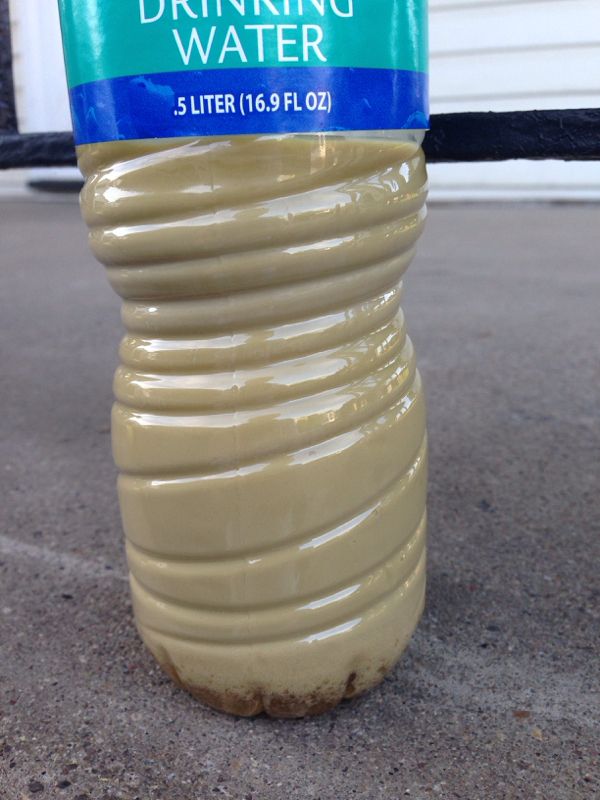

This is what were draining out of them, and this cannot be ingested without piston and or rod failure.

No, turbo and pistons and the entire engine is amazingly good! In fact the turbo's are very good quality. Awesome engine, very high quality and outstanding engineering. The issues are caused by trying to short cut the PCV system to save production cost's, and that most likely had nothing to do with the engineers themselves, but was an accounting and management decision. These things allow that department to claim victory by meeting their set goals, but down the line cost more in warranty claims and repairs. All politics within the hierarchy. These were/are the most frustrating aspects of the engineers job's from way back in 1974 when I first started w/GM and got to know some personally.
This is all due to releasing a turbo charged engine with a PCV system that only evacuates when in boost. Here is a good training video that explains all the functions of a PCV system. This of course is only for a NA application, but the principals are the same. So after watching you can see how the ATS ends up with these compounds accumulating in the crankcase, and then when the pressure building in the crankcase forces this mix out the fresh side inlet.
https://www.youtube.com/watch?v=EPIfI9aZHt4
Correct this, and the problem goes away.
