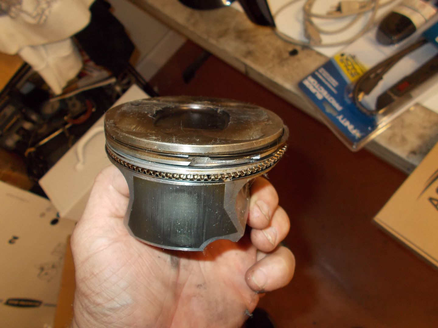

Could all you guys who have seen bad pistons or blown motors on the 2.0T please post to this thread along with your build date? It would be interesting to know if you are/were tuned, but I don't think that info necessarily needs to be shared (especially if you are concerned about "privacy").
There are a lot of assertions what GM did or did not do and when. Let's try to generate some facts! GM is not sharing their data yet, but I think this community is large enough where we can start compiling some data of our own.
Who wants to go first?
#2 · (Edited by Moderator)
i just started a list with a list of members i found that reported failures. (i posted a link to this list in the CTS section so they can add their failures and info to this list)
of course i dont have build dates of other member cars, and mine is at dealer so i cant look
TSB for piston failure *PI-1178

ok so this is getting ridiculous. my car is at dealer currently. they are installing a entire new long block.
we need to start a list of members who have had piston failures so we can keep track of build dates, gas used etc.
my car is at dealer so i cant currently get build date.
fuel other than first tank dealer stupidly filled with 87. (they dont care its cheaper) i only use 93 octane from shell or marathon. & never fill up when i see the tanker there stirring up all the trash in the tanks.
my car is a 2014 i purchased 4 months ago with 3 miles on it. car went back at 16xx miles for Human interface module replacement (CUE) . car currently has 47xx miles. at 1626 miles i changed the oil and filter AC Delco filter Mobil 1 5w30 oil.
symptoms were: service traction & stablitrac message, rough idle, lots of burnt oil smoke out of exhaust, loss of power & CEL for misfires in CYL #3.
i did not do a compression test. i just had car towed to dealer. (my service writer is kinda dumb so i couldnt get any answers from him on what tests they did) mine is the first failure they have seen at my dealer. my service writer said "Might be low on oil" LOL. i didnt tell him i work at a shop and consistently build 1000+ hp cars. and have been working on cars & building engines for 20+ yrs.
talking a with guy on FB in the CTS-V pages he is a tech at a caddy dealer, he claims in the past few months he has personally repaired 8 cars with failures of 2.0t pistons. he claims #3 seems to be most common but most engines have failures on multiple cylinders. most recent engine he was doing and posting pics of had failures in cyl #1,3 & 4.
yes of course my dealer is fixing car under warranty and gave me a loaner car, but this issue seems to be far worse then just a bad batch of pistons. i understand a batch of pistons could be 1000+ but we need to keep track of info so we can know what cars might be affected. (for resell and potential buyers in the future)
when i get my car back i will post build date VIN whatever so we can try to figure out a window for affected cars. that to say the 2015s dont end up having failures as well.

I'd also request users post their approximate miles at failure, which cylinder failed (if they know) and whether the dealer replaced the pistons or the whole longblock or shortblock and any compression test results the dealer or service shop will share.
That way we can see when they fail, how they fail, and what is being done about it.

#1 failure is most common as this is the closest to the incoming water/fuel/gunk entering from the intercooler. It is the first one to ingest the mix and partial hydro-lock occurs when the piston cannot compress the liquid, putting more pressure on the top ring forcing it on the top ringland where it breaks:
