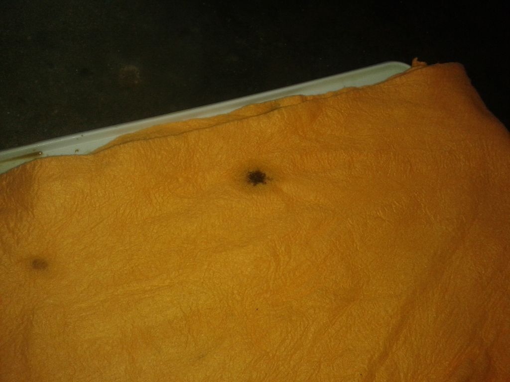

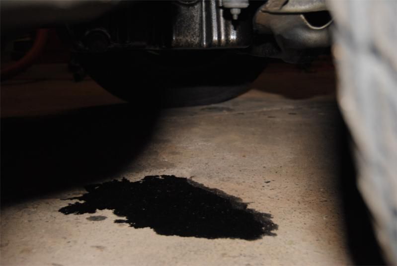

Okay I just got my caddy back from the repair shop, I had a new Rad, Oil cooler lines and Oil Filter put in. The Rad and Oil cooler lines are not leaking at all. The oil filter however is being a pain in the ass, this is my second oil filter! The first one leaked none stop, This one leaks when the car is parked on a tilted surface and here's the kicker it leaks when the car is not running....:mad2:
So what can I do to fix this, is it because I'm using an NON-OEM part? Who else has had this problem? What oil filter do you recommend?
This Picture shows the oil leak, (Car is parked on a tilted surface)
This Picture shows just one drop of oil, (Car is parked on flat surface)

Never heard of oil filter leaking on an LT1. Make sure it does not come form somewhere else. It's a pretty bad leak.

I know its coming from the oil filter because the thing is soaked in oil from the top of it to the bottom. I'm wondering if its a gasket problem because if the car is parked on a tilted surface the oil seeps down the side of the oil filter

Okay so the oil leak has been fixed, the problem was a split in the oil cooler line and it was dripping onto the oil filter making it look like the oil filter was leaking Thanks everyone who offered their opinions :)
