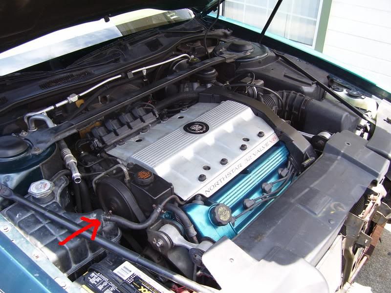

where exactly is the purge line on a 1994 cadillac sts
is it the line right by the radiator cap if it is where does it connect to car is overheating

It's this one. It travels under the intake plenum to the throttle body then to the water pump crossover. Disconnect it from the surge tank and start the car to check if it's plugged. It should trickle coolant while the engine is running. If it doesn't then it is plugged and is likely the reason for your overheating.
The one right by the radiator cap is the overflow tube. It doesn't connect to anything.
