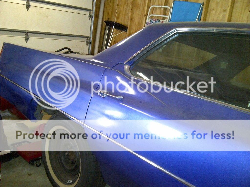

Weather is getting pretty nice up here in Maine and I've decided to start work on the '69 Calais next weekend. I went up to look at it again this past weekend and took some pictures. Click to enlarge...
That's where she sat all winter...
My favorite picture...but the grill trim is cracked. Anyone know where I can get replacement? :)

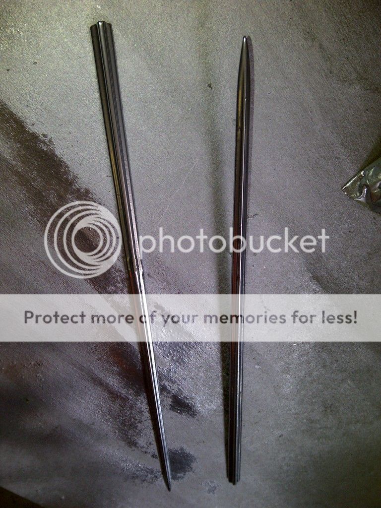

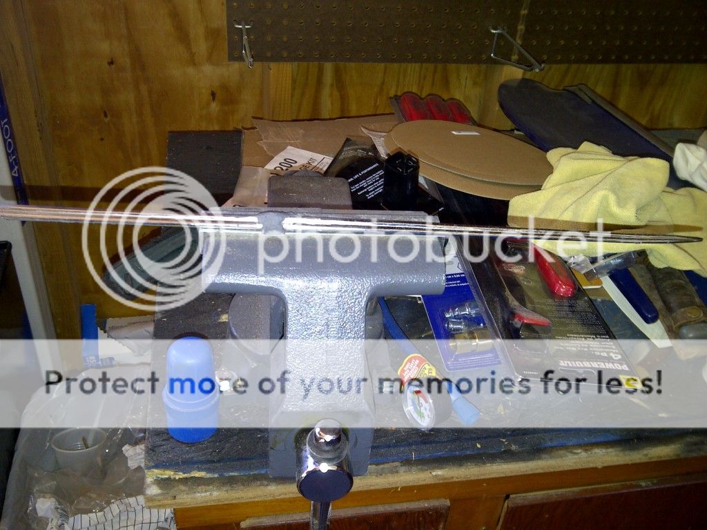

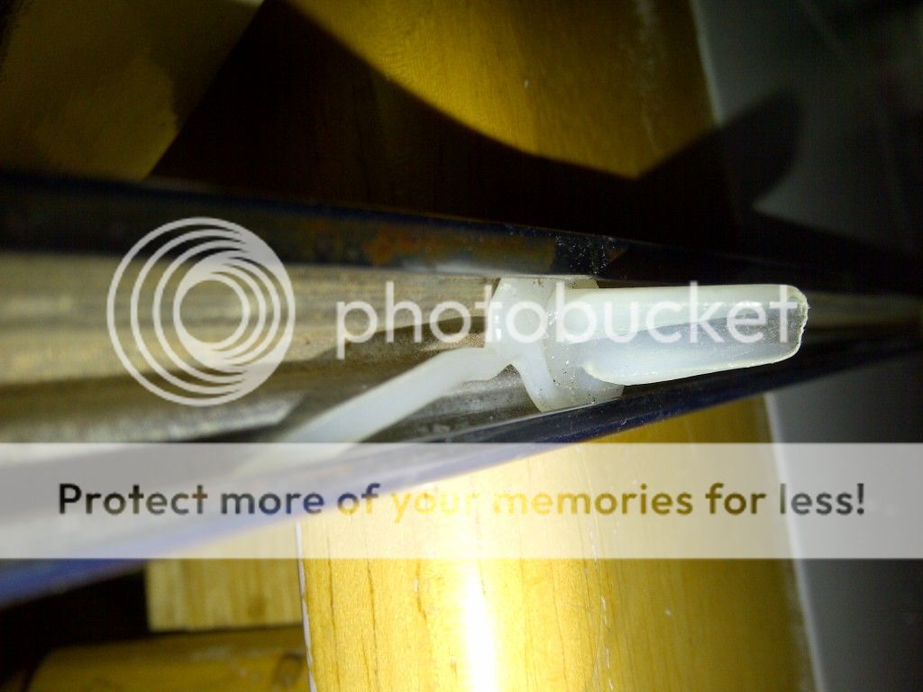

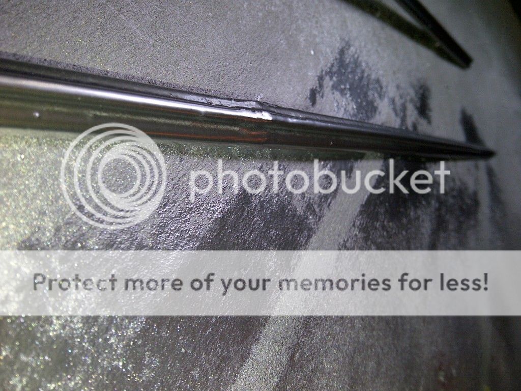

The front fender "spears" were snapped in two...Here's my attempt at fixing:
Step 1: JB Weld quick steel putty and a couple of small trim nails for support:

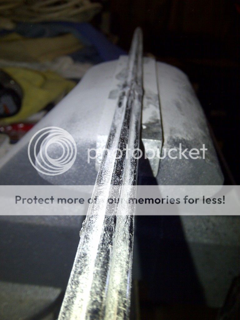

Step 2: bust out the dremel with a grinding stone and grind down the excess JB Weld
Step 3: some chrome spray paint. It was a little too cold in the garage so it was tough to paint but I may redo the paint at a later date.
Came out OK. you can still see the spot where it was repaired but I'd say it's better than not having them on at all.
