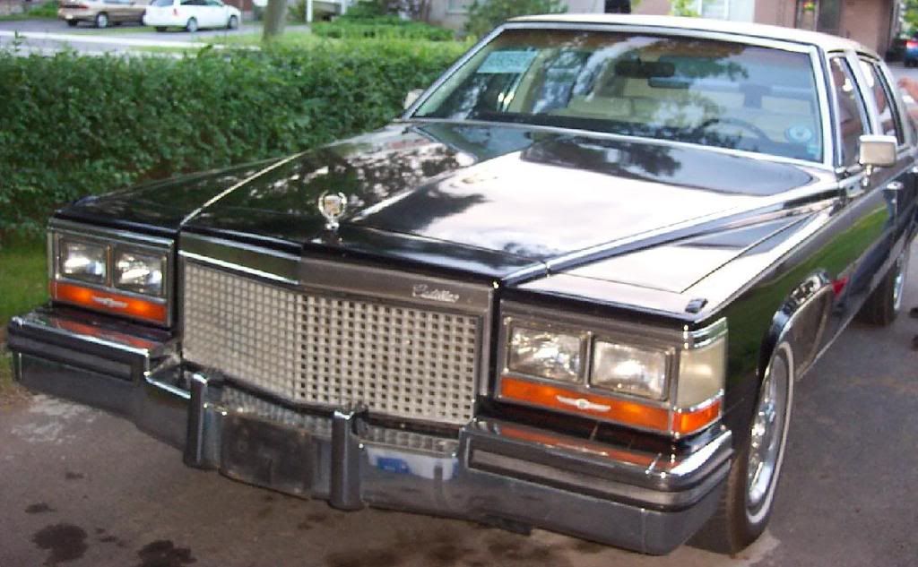

Hi guys. I haven't done much posting but a lot of browsing since I've registered, but I have a question:
I got a black 87 Brougham whose battery drains when its left sitting too long. I've found that the 'security system' light comes on when I push the door lock button, but it doesn't turn off after a few seconds (as the manual says it should). I've also found that when I start driving the doors don't automatically lock as they should, from experience with another Brougham.
Based on this info, would you say that the security system is the culprit? If so, could I fix it just by removing a fuse (I suspect not, as that would make it too easy for someone to disable when stealing your car). Should I just take it to a mechanic specializing in electrical?
Thanks guys.
Ps, here's a pic:
