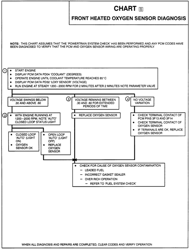

P042 = Left (towards the front of the car) bank O2 sensor signal lean.
That could be why you're getting more hydrocarbons. If the sensor sees that it's lean, the PCM will make the injectors stay open slightly longer to give it more gas.
Let me see if I can get you something for that code.
Edit: Here ya go:
PD32 is in the "PCM DATA?" menu in the on board diagnostics.

Just finished troubleshooting....
PD32 fluctuates above .3v. Referring to NOTE and checking Snapshot Data Parameters, PD38=160 and PD39=113. Dont know if that determines both banks were lean or not or how to check condition that would cause lean engine operation.
