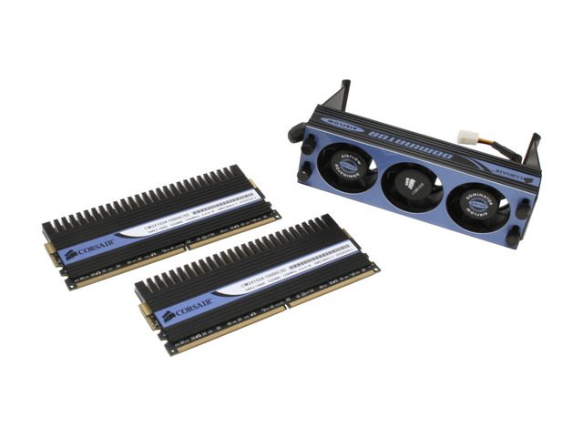

CORSAIR Dominator 2GB RAM (2 x 1GB) (PC2 10000)
Speed: 1250 Mhz
http://www.newegg.com/Product/Produc...82E16820145171

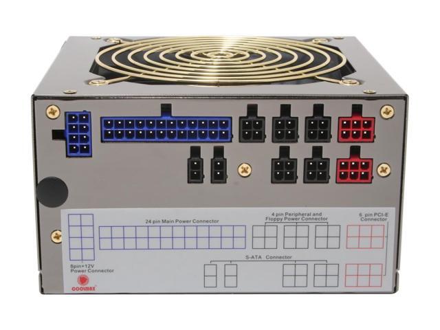

COOLMAX CUG-700B ATX 12V( V.2.2) 700W Power Supply
http://www.newegg.com/Product/Produc...82E16817159058

Same thing with the ultra-expensive Corsair RAM... I can get by with 2 Gb, but will grab another matching set once the price drops...

The only thing I would look at is PC Power and Cooling for the PSU. Sometimes they're not extremely fancy BUT in every test shown they're the most accurate and consistent with voltages. There 0 fluctuation at all times, even under heavy load.
I'm running the TurboCool SLI
http://www.pcpower.com/products/view...hp?show=T51SLI

the memory is nice as long as its matched COrsair will sell you unmatched I would choose the dominator 2048 matched the video card is a good choice but I like the Quadro FX5500 but then again thats a whole hell of a lot more money.
