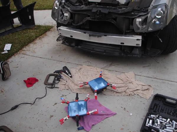

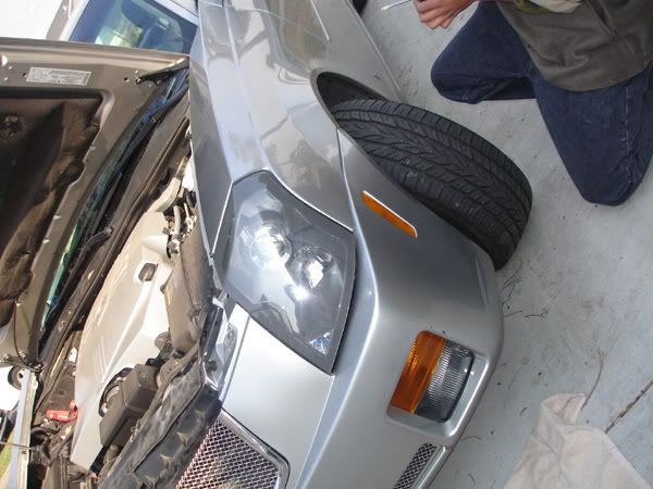

?!?!? You have to remove the entire bumper?? Or is just easier to access??

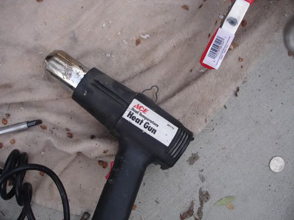

you dont have to... her did. i really dont know why, and i dont know why he used a heat gun... and i dont know why he did every thing out side
You not supposed to?

not necessarily,
you pull the wheel wells out & you're granted access to the fogs & can remove them right there...

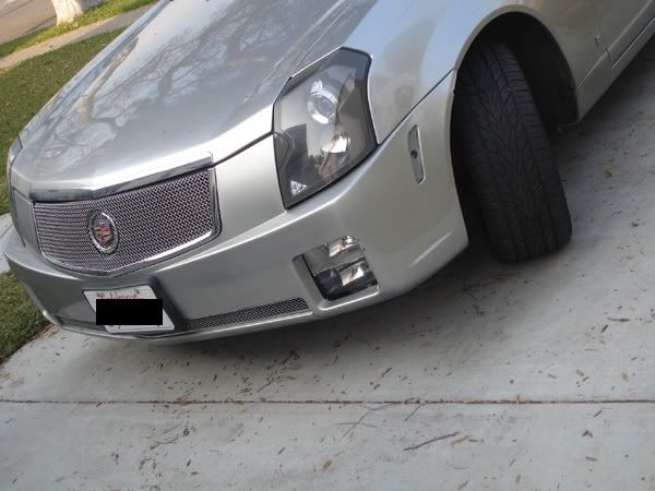

sticckz, looks good

Yeah Sticckz, looks clean man!

Easier through the wheel wells.
GOOP is the best adhesive, period. Not as fast, but the best for this project.

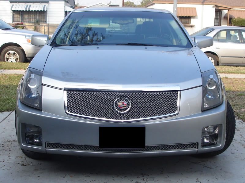

Happy new years to all!!...
i'll but up some pics of how my fogs look..
way brighter now...that i broke the light cover off..
lol...i think its a simple project, if done rite...
however i made a few mistakes that complicated the project..
if done properly tho, should be very easy!!!

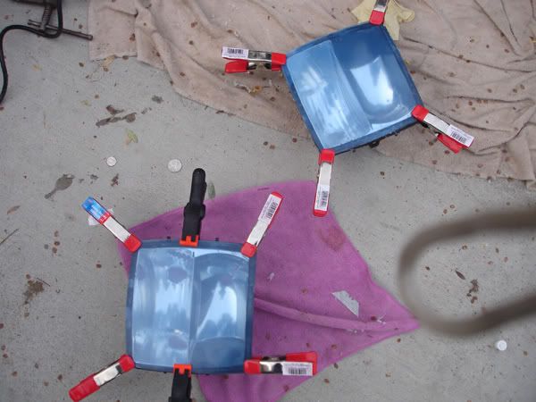

I bought WW fogs a while back, but never used them. I now have a set of STS-V fogs installed, looking good, and a pair of stockers sitting in my closet.. right next to the WW fog lenses.
I think I'm going to get down to it and actually put them on, since I have the whole winter to do it. Smash out the old lenses with a hammer or something, remove all the old plastic (I refuse to use the bake method), get some 2-stage epoxy, clamp the shit out of it, wait 48-72 hours, install them in the spring? HIDs should look nice in there, I am wondering if I should remove that shroud inside or not? I guess that once I do I won't be able to put it back in there...?

I'm almost in the same situation, I bought all the lenses and then only did the sidemarkers. I ruined a sidemarker in the baking process before I just decided to smash them. I really want clear fogs but the baking process has scared me away so far after the mess it was for the sidemarkers. Was looking at STS-V lights but that is a much more expensive option.

FWIW - the baking of the fogs is a no brainer - much sturdier plastic and warpage highly unlikely. The sidemarkers melt in an instant.
