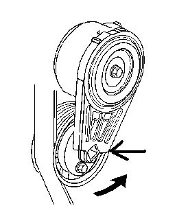

Position a 3/8 inch drive wrench on the drive belt tensioner arm and rotate the arm counterclockwise. Theres a reciever for the wrench itself on the tensioner, where the pulley is.

That picture doesn't look like my setup... you sure it's for a 2000 catera?

See if this helps, a whole tutorial.. only problem is the drawings arent that great.
http://dante.myftp.org:9001/servlets...m&cellId=40111

Just what I needed.... got it back in. Major thanks!!!
