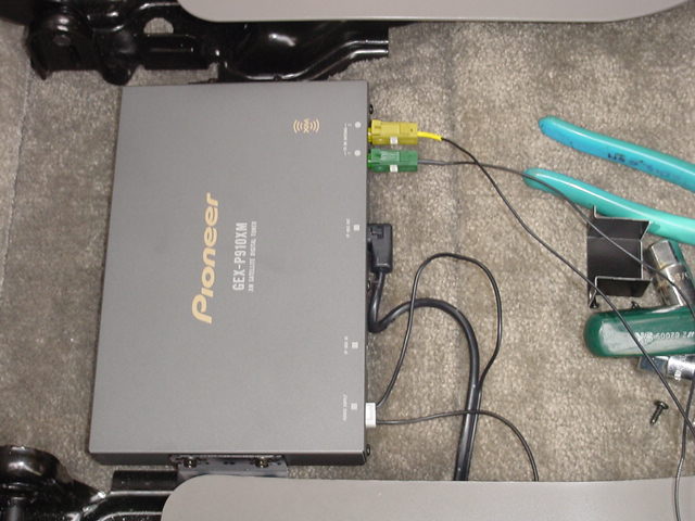

That looks EXACTLY like the unit I bought and put in my Prelude (with a Pioneer tuner and 12-disc changer).
According to Crutchfield, it IS the same unit. I'll have to go check the model number on mine to be sure. If it is, all I would need is an adapter cable to move it to an XM-ready GM car, and I may not even need that!
