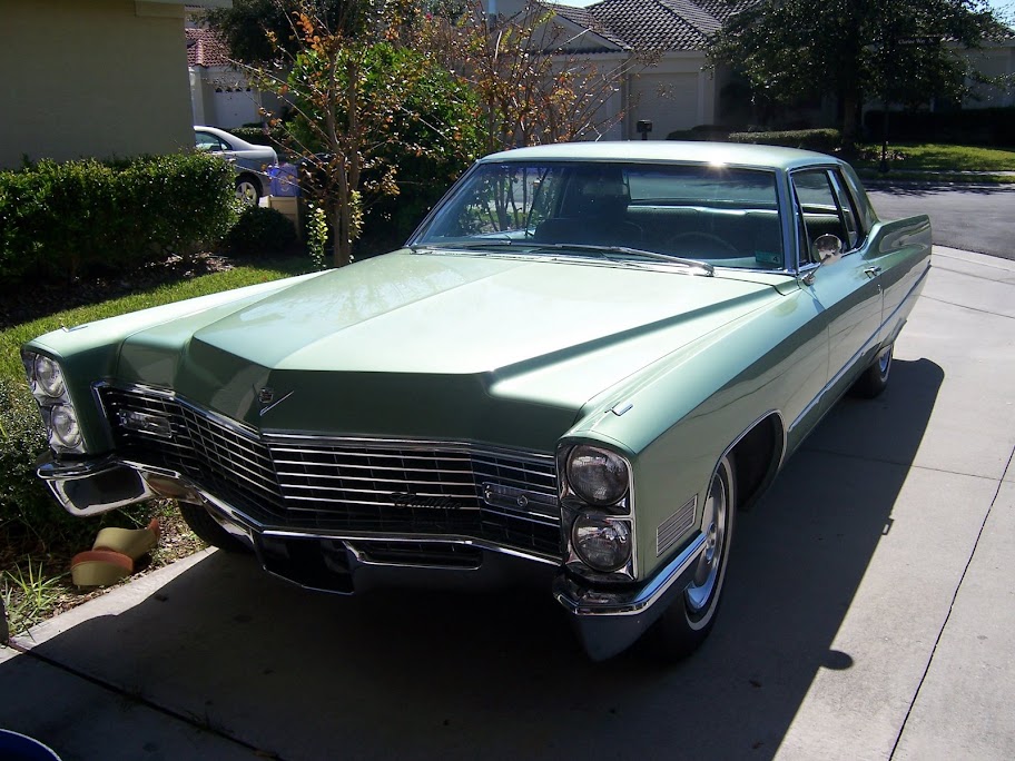

Thanks for the reply. Here's a pic.
So...changed points, condenser, rotor and cap, and set dwell and timing. Still got the same problems. Runs rough and sputters. Also has no power when in gear, and as I said before it ran great about 10 miles ago. Any oldtimers see this before?

Sorry, pic didn't link up. Here it is again.
