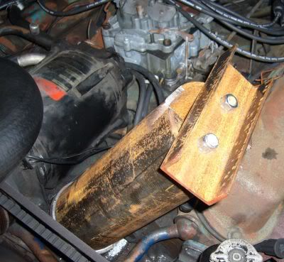

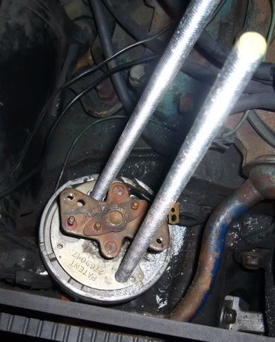

    BFH worked! BFH allowed me to twist it an RCH, and then up and out. Thanks guys. It's a good thing I was junking the old distro though. I had to drill two holes in it to attach my Twist-O-Matic (TM). Now if I can just get the new one working...

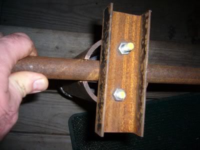

    Very clever design, could I see a picture down the center of that pipe?

    Maybe you can list the proper curse words for us also. I really like that home made whatever it is.

    Thanks for the interest! I used a hacksaw to cut tabs in one end of the pipe, then used a vise to press the tabs inward, creating the slot for the breaker bar. Drilled two 3/8" holes in the distro, inserted two 12" long pieces of 3/8" all-thread into the holes and put washers on the all-thread underneath. Then slid the piece of 3" Sched 40 pipe over top of everything and sat it down on top of the distributor. Drilled the matching two 3/8" holes in a piece of channel, stuck the piece of channel on top with the all-thread poking through its holes and fastened with 2 more nuts. Tightened it all down. Slid the round bar into the slots in the pipe and then I had all the leverage I needed. The tall piece of pipe was, of course, to elevate the breaker bar above all the other crap in the way (AC compresser, belts)

    Forgot the pic that JTraik asked for!
