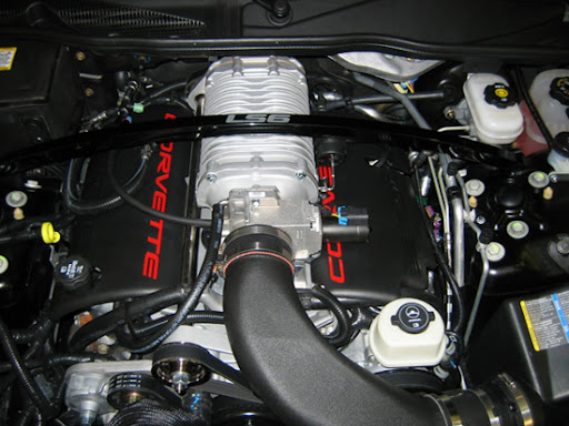

Also, here's a better way to route the intercooler coolant flow (NOTE: You have to reverse orientation of the HEX.) and the second pic is how I purged the system of air bubbles (crude, but hey! ... it worked!):

Oh, and btw, if you reverse the HEX orientation, you'll have to make brackets to accommodate mounting it.

So as to provide a measure of stealth when you pull behind someone, you may want to subdue the the glare of that bright aluminum heat exchanger peeking out from behind your grill.
EDIT: Oops! Pic is not uploading.

Dang thing was too big ...

Rick emailed me a file with the V, I printed it out, cut it out, then masked off the front of the HEX before spray painting it black.
Of course, Rick was much more elaborate with his.
Trouble is, painting it hides the HEX from view alright, but you can't see the V at all.
